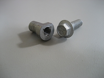

    1. Discard the old hardware (pin, bobbin, flat washers) and use only the new, simple-to-install RB hardware came with the order. Our hardware is self-locking, does not require thread locker, and keeps consistent torque regardless of the temperature, unlike Loctite 290, which has a temperature limit of 300 degrees F.
Stoptech Fasteners - contains a flat washer that was formerly conical!
RacingBrake Fasteners - includes self-locking hardware - no Loctite necessary.
